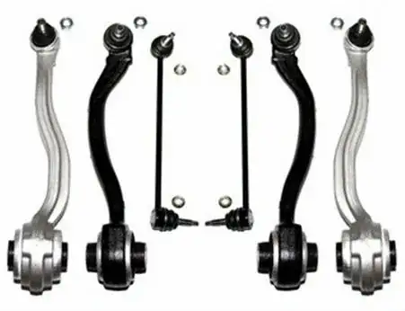

the control arms i replaced
control arms kit
