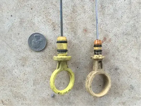

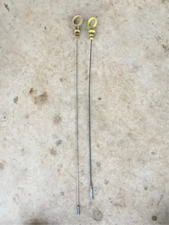

So, here's the difference between the Solstice and Malibu dipsticks (both 2.4L LE5)
The shorter one with the larger diameter, bright yellow handle is from the Solstice. Fortunately it was still in the shop on one of the old engines.
