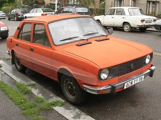

One day...this year :) I will be working the body work of the car I'm rebuilding (Skoda 120 Estelle '72) and one of the things I want to do is to hide a line it has half way down, from tip to tail. I hate it :) it is not well placed aesthetically.
It is a line not too deep (and in this car, even less deep because lots of layers of putty) and I wonder if with coarse body filler I could hide it without having the risk of getting the filler off because the depth it needs to cover (maybe 1/4" to 1/2", about 1cm). My idea is to use coarse filler to hide the line, then thin to work the panels completely. Would it work?

If this car were to come in to my shop with the request of removing the body line down the middle using only filler. I would take a body hammer (one with a pointed end) and knock the body line in so that it would be an inny and not an outtie. Be extremely careful not to concave the entire panel doing this.
Doing this will save you extensive hours of shaping and feathering the putty so that it doesn't look pregnant.
My favorite to start with is a fiberglass filler, you can generally cut this down really quick with a 60 grit. I would recommend an air file for this. if not than an 8" single action sander. (You will spend alot of time at this point using a DA pad)
Use the lighter fillers when you have the shape down, and feather it out using that DA sander from 120-240 grit.
