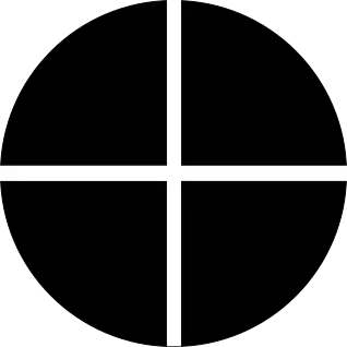

If you view a circle in your mind:
Let's say the radius (arbitrarily) is 10 units. That means that the distance from the center (where the two lines intersect) to the edge of the circle is 10 units.

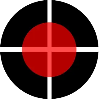

Now let's subtract 50 percent from the radius:
Because circumference is directly and exponentially related to radius:
c = 2πr
...it's a decent assumption that in order to cut the radius of the circle in two, you would have to double the steering power. In other words, the back wheels would have to turn exactly the same as the front wheels.
Therefore, to knock of 25% of the steering angle, you would have to turn the back wheels 50% of the angle of the front wheels. Now let's transfer that over into the snaking. Let's presume that the maximum steering aid from the back wheels would be 50% of the max turning of the front wheels.
