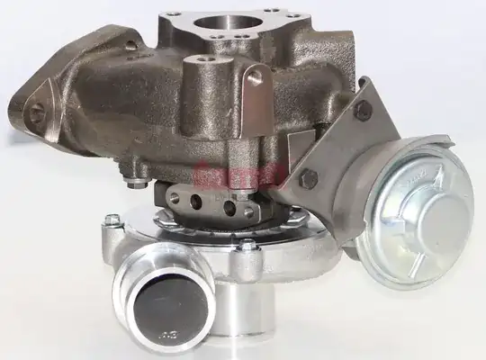

The Garret Turbocharger model GTA1749V is indeed the same for a lot of Toyotas, but versions can - and do - differ. Look at this model: This is the Turbo compatible with my Toyota CLM20 (Avensis Verso)

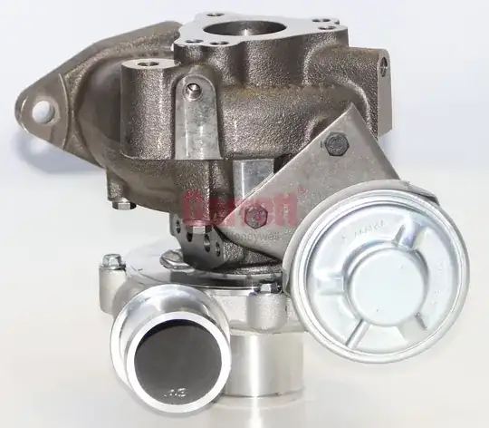

And then compare it with: This is RAV4 turbo
SO you can see that while they look essentially the same, some angles are different. And, obviously, they can be either adjusted or the engine compartment (and hoses) can take a different versions. Or it's just an aftermarket seller's spiel.
