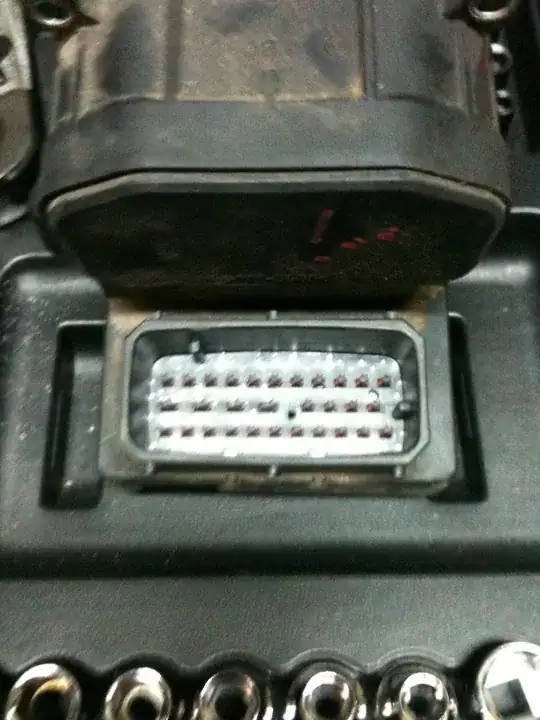

From what I can see on the replacement, it should just come off:

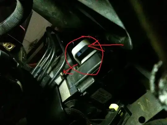

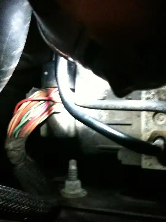

However, I am pulling but nothing is budging.
Is there a special way to remove it?

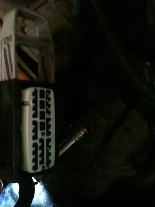

You have to pull (really hard) on this grey lever.
It comes out about 3 inches vertically and unlocks the connector:
