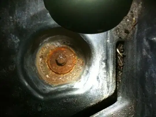

Trying to change the ABS module out.
Need to remove the battery tray - there are 4 bolts.
However, one of them is smaller and has has a weird round top:
(not sure why, the Ford Parts website shows they are all the same but the other 3 seemed to be 10mm standard bolts and came right out).
Have the standard Sears 100 piece socket.
Tried every metric and standard socket and none of them fit properly.
It's almost like the 6 sides are not standard socket sides?
Tried a vice-grip, won't budge either.
Any idea how to remove this bolt and what is it ?

The head is probably just rounded off. Hammer a 3/8" socket on or use a 10mm twist socket on it. Maybe heat it or use a penetrating fluid on it as well.
Worse comes to worse the head snaps and you have to drill and retap the bolt hole.

It looks like ViceGrips would have to come in vertically, so you won't have much leverage with just the pliers, but you can use an adjustable wrench or water pump (slip joint) pliers, or maybe even a screwdriver slipped into the opening of the jaws to get some extra torque.
You may want to soak the fastener in PB Blaster or Kroil (or whatever your favorite penetrating oil is) and let it sit for a while before you try to get it to move. If you can get it to move at all, it would be worth adding more penetrating oil. Based on the way that is rusted it is quite likely that the threads are in bad shape as well, the one thing you don't want to do it to do is to twist off the head.
