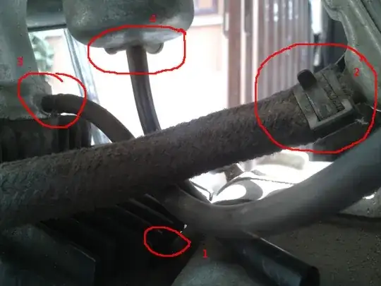

What in your opinion might be the possible causes of such a problem? Images of the engine area are here: Troubleshooting fluid leakage onto the engine area?

I can see why the mechanic couldn't figure it out. It's hard to locate the source. At first the sound seemed to come from point1 in the picture. Then it seemed to be from point2. Then it seemed to come from the general area between 1, 2, 3 and 4. I need to debug this like how I debug software. Is it safe to yank out any of these tubes, plug them with my finger and push the kickstart pedal to check if the sound still exists?

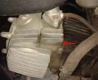

The red arrow points to where the sound originated from.

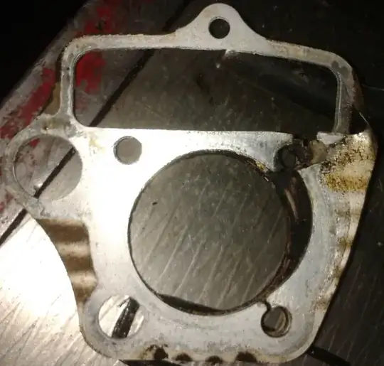

You estimated the problem and the cause correctly. The head gasket was damaged, and it was damaged exactly because they didn't replace the gasket with a new one after doing the engine head cleaning. The service person at the authorized service center today listened to the sound of air leaking and immediately concluded that the gasket was the problem. He admitted that it is the first time he's ever heard such a sound though, and proceeded to move the kickstart levers of other bikes just to check for such noises. The dismantling was done in front of me, and this is what the damaged gasket looked like:
