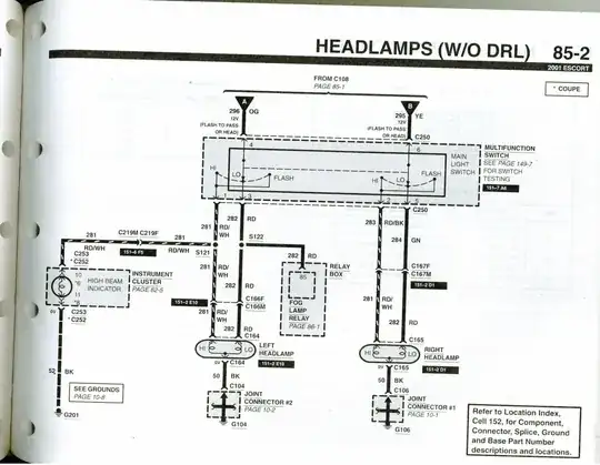

Wiring diagrams (click to view larger)
  • Left: main fuse to headlamp fuses
  • Right: headlamp fuses to headlamps

Fuses blow because they get too hot and they melt. So, either you have:
  • A short – which you don't because the light works, although you might have a high resistance short, check that by disconnecting the bulb and measuring between the fuse terminal and ground, the resistance should be infinite. Another sign of a high resistance short is that the bulb may not be as bright is the one on the other side.
  • Too large a bulb in the light, you can check this by hooking up your meter where the short finder was, you should see about 5 Amps. If the draw is up around 10 Amps, then that would be the cause, check the bulb it may be the wrong wattage or have internal damage that behaves like a high resistance short.
  • Fuse terminals that are making poor contact, that could cause the fuse to heat up and blow – if the fuse takes a long time to blow (more than a few seconds) and the current drawn by the bulb is reasonable, then overheating is the most likely cause. If the fuse block terminals are making poor contact you may see evidence of melting on the fuse or around it.
  • An environment around the fuse that is be too hot and that combined with the heating of the fuse due to the current drawn by the headlight may be enough to blow the fuse.

There are two kinds of shorts, dead shorts and partial shorts. With a dead short the load device will stop working with the tool connected because all the current shunts to ground.
With a partial short only some of the current is shunted. This will cause an over current but with the tool connected, which controls the current, the load will work.
Disconnect the head light. Connect the tool as directed and continue diagnosing as directed.
