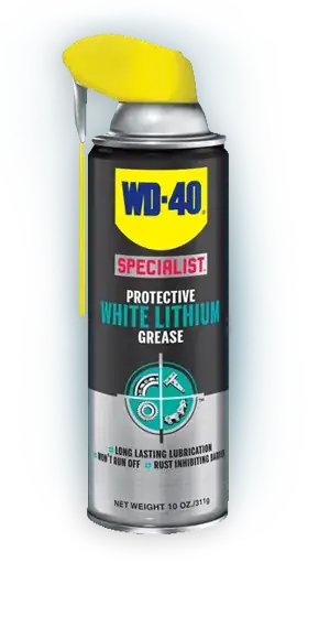

My weapon of choice for such a job is something like WD-40's White Lithium Grease:
WD-40 White Lithium Grease
(source: wd40specialist.com)
