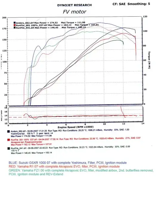

One thing others have not mentioned here is that 'peak horsepower' is a point measurement, but performance comes from the integral under a power-curve, so equivalent engines with lower peak horsepower figures are not necessarily de-tuned, as in made to run with a lower thermodynamic efficiency. They are often tuned differently to distribute that integral over different parts of a powerband rather than piling all the performance into a narrow band, hence the lower peak-horsepower figure. That said, production vehicles do tend to tune on the conservative side of peak power output for longevity. 7-angle valve-seats may radically improve flow-bench numbers, but they will also need to be refaced much more often.
The VW Phaeton weighs 5400lb, while the Nardó weighs 2600lb. You can be sure that the Phaeton needs more torque at lower RPMs to get those big comfy couches and coffe-tables rolling. An equivalent motorcycle comparison might be the sporty Yamaha R1 vs the more touring/commuting-oriented FZ1. These use identical engines with similar levels of efficiency but very different performance characteristics. The FZ1 has a broader power-curve with much more power down low, around 3000rpm, while the R1 is producing 15 more horsepower at 8000rpm. enter image description here

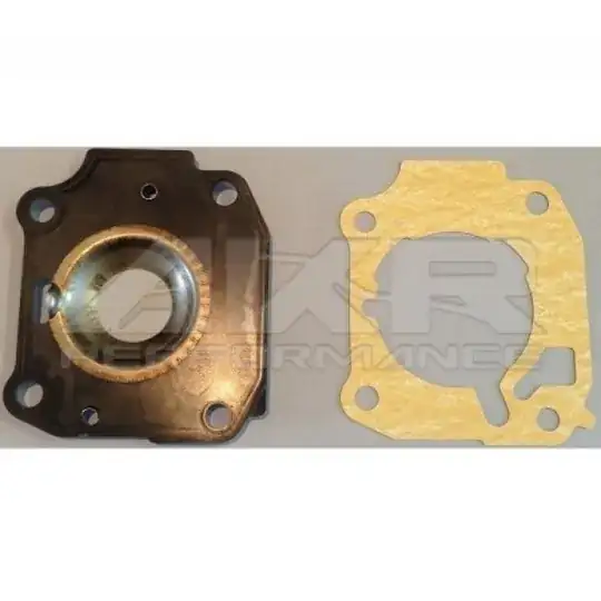

Since you said this is a generic question:
One example from the 1996-2000 Civics:
They just used a restricting gasket before the throttle-body to limit airflow for the 75 hp model. For ~$7 you could buy the 90hp gasket for a swap and have a cheap tune.
Nowadays this is usually done electronically via ECU. But don´t be fooled: The higher power models often have a lot of secondary modifications which are not immediately obvious.
This goes from the motors internals (higher spec) to the cooling system, transmission, power train, breaks, suspension etc...
Honda gasket
Image: https://www.all4honda.com
