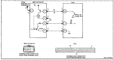

This leaves me with a faulty ECU. The diagram below explains how the entire circuit works, what it looks like. The problem appears to be between IMRC Terminal 1 and PCM Pin 42, which is now permanently closed irrespective of engine RPM when it should be in a different state if RPMs are less than 3,300 and in another state if RPMs are higher than 3,300.

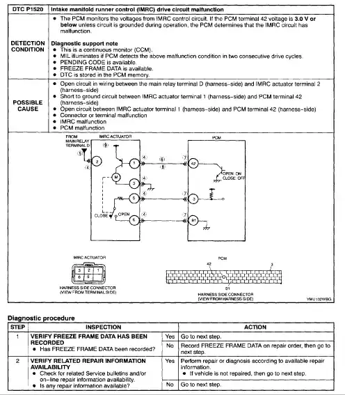

By the way I followed all the manufacturer guidelines for fixing this except one step. I have two error codes P1520 -IMRC Drive Circuit Malfunction and P1512-IMRC Shutter Valve Stuck Closed, and it says if one has followed all the steps and the problem is still there, replace the IMRC Actuator and if that still fails, then the PCM.

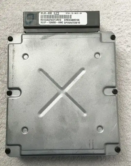

Here is the ECU I am talking about: the problem ecu from a Mazda MPV 2000

Even with the wiring harness fixed, the voltage drop at:
  1. IMRC Terminal 1 which is the IMRC Control Signal from PCM and
  2. IMRC Terminal 5 which is the IMRC Monitor Signal to PCM
does not match manufacturer specifications
The voltage drop readings should be as follows ( manufacturer specifications)
  1. IMRC TERMINAL 1 at idle = B+
  2. IMRC TERMINAL 1 at 3,300RPM = Below 1.0V
  3. IMRC TERMINAL 5 at idle = 5V
  4. IMRC TERMINAL 5 at 3,300RPM = Below 1.0V
But in my vehicle it reads
  1. IMRC TERMINAL 1 at idle = Below 1.0V (about 0.04V to 0.08V)
  2. IMRC TERMINAL 1 at 3,300RPM = Below 1.0V (about 0.04V to 0.08V)
  4. IMRC TERMINAL 5 at 3,300RPM = 5V
So to me the problem appears to be internal to the ECU at Pin 42

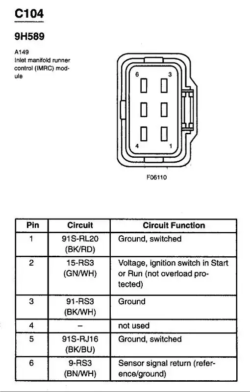

IMRC Terminals and their functions

ISSUE 1:
You said: The voltage on the line between pin 1 and pin 42 is provided by the IMRC.
You also said: The sensor on the other hand, inside the IMRC there are no connections to power. The sensor is just a dumb switch. The power connection is inside the PCM and the IMRC pulls the signal low.
Does that not sound contradictory? Can the voltage be provided by the IMRC if the power to the IMRC comes from the PCM?
What is the purpose of IMRC Terminal 2's connection to Main Relay Terminal D?

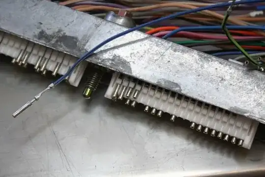

Should it be pulled out as shown in the picture? ECU with one pin pulled out

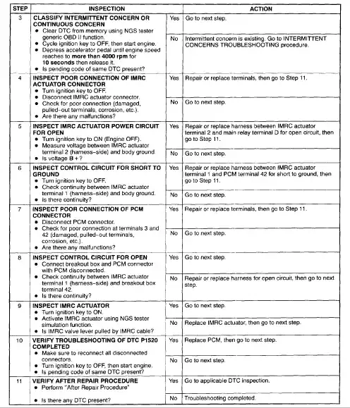

Based on your answer below, the IMRC is dumb, it is the PCM that supplies it power and ground. If then I have a problem with PCM Pin 42, it then means that even if the PCM is perfect, the PCM terminals may be bad - that is damaged, pulled-out or corroded! Which brings me to the realization that while I have done all the other tests, I did not attempt to inspect the PCM Connector as advised in step 7 in the attached diagram.
Mazda MPV 2000 P1520 DTC Troubleshooting Workflow part 1
Mazda MPV 2000 P1520 DTC Troubleshooting Workflow part 2
Any special precautions for repairing PCM Connector pins?

It is much more likely that the IMRC is damaged.
The voltage on the line between pin 1 and pin 42 is provided by the IMRC. The PCM then pulls that voltage to ground to turn the IMRC on. When the IMRC is on the voltage on pin 5 drops to below 1v.
In your case the the voltage between pin 1 and pin 42 is always below 1v. This could mean one of two things.
  1. The PCM is always grounding the pin. In this case the voltage will always be below 1v. But this also means that the IMRC will be on all the time and the voltage on pin 5 will also always be below 1v. This is not the case.
  2. The IMRC is no longer supplying power and regardless of whether the PCM commands the IMRC or not the voltage will always be below 1v. In this case the IMRC will always be off. This is signified by that the voltage on pin 5 is always high.
First make sure that the voltage on pin 2 of the IMRC is B+. If it's not then diagnose this first. Next pull pin 42 out of the PCM. Run the engine and check what the voltage is on the pulled out pin. It should be B+. If it's not but the voltage on pin 2 from the previous test is OK the the IMRC is damaged.
Issue 1. The IMRC has two circuits inside. A high power circuit and a low power circuit. There is no electrical link between the two circuits, only a mechanical link. The high power circuit contains the control transistor and motor. The power comes through pin 2 to the control transistor. Then goes to the motor and the gets grounded through pin 3. To turn on the motor pin 1 gets grounded. The PCM can not provide high power. All the PCM provides is a low power control signal which in this case is a ground. The PCM ground pin 1 turning on the IMRC control transistor and therefore the motor. In this case the current flows from the base of the IMRC control transistor to the PCM. The low power circuit is the sensor. The sensor is just a dumb switch. The PCM contains a pull up resistor to 5v. When the switch is open the PCM sees 5v. When the switch closes current flows from the PCM to the IMRC and the PCM sees less than 1v.
Issue 2. Yes pull the pin out as pictured.
Issue 3. The B+ could be used from anywhere. Getting it from pin 2 of the IMRC harness would probably be the most convenient. Yes the resistor is connected to the harness and not the IMRC.
Issue 4. Yes the IMRC is dumb but the PCM only provides a control signal. See issue 1 answer. What the diagnostic procedure i gave you provide is a way to figure out whether the IMRC control transistor is bad or the PCM control transistor is bad. It could be one, the other or both. It could also be the wiring between the PCM and IMRC. Check the continuity of the wires while the PCM is disconnected. To repair these the best bet is to go to a junk yard and cut the connector out of another MPV. Then pull the pins out as pictured and replace them in your connector.
