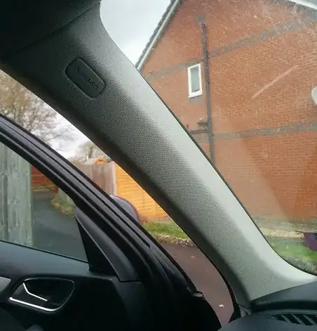

Am I on to something, or is this test unrepresentative because I'm pouring more water in the sunroof drain holes than would happen normally (especially as the sunroof is usually closed)? What next? Removing the trim on the A-pillar? What will I see under there and how best to remove?
A pillar trim

I see what you're talking about with the water coming down the A-pillar. The place where the leakage is most likely to occur is where the sunroof drain connects to the drain tubing. You'll have to dismantle the sunroof to get to where I'm talking about. You may be able to get at it by removing the hoodliner inside the car. I would take the A-pillar bits/pieces apart as a last resort, due to their being an air bag present there. If that blows up in your face, you're going to be in a world of hurt. If you take the sunroof out, more than likely you'll find the tubing has partially disconnected from the drain. Ensure it is fully seated, there's no cracks in the tubing itself, then reattach the tubing using some rubber cement to ensure it seals up nicely.
