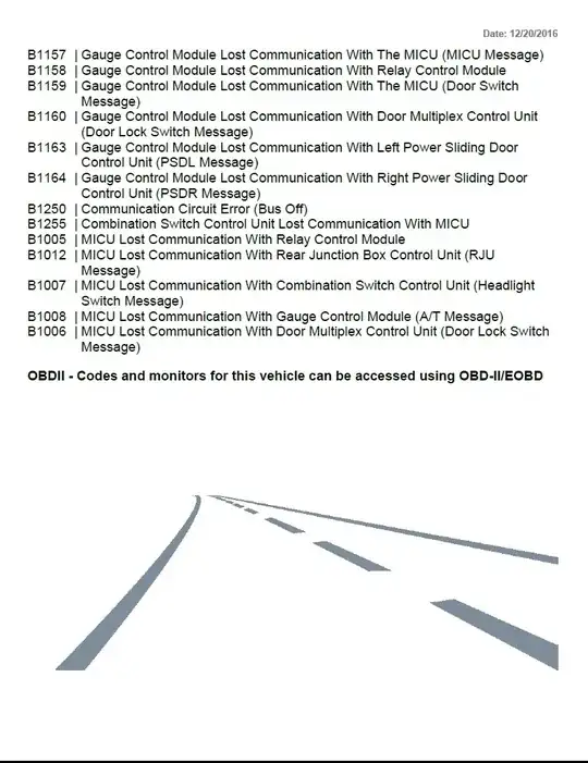

This one was a good one... or at least a little amusing... lack of pictures on this one it was cold and not fun being outside. 09 Honda Odyssey 3.5l comes in and doesn't start. Engine cranks over, nothing happens. Sounds like it has good (enough) compression. Checked for codes...
enter image description here enter image description here enter image description here enter image description here
Nice... I think 32 is the most I've seen yet. And no engine codes...
