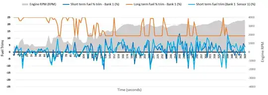

I have a 2002 Toyota Corolla (1ZZ-FE engine) and I am trying to understand the fuel trim values I am getting in real driving conditions from my scan tool. I have P0171 code (lean condition) that comes on and off. I posted earlier about this, but I fixed a lot of things in the meantime. I was hoping someone could take a look at the screenshot attached and tell me if these values look off or not.
  • STFT mostly remain between -5% - 5% which I think is great.
  • LTFT, however, ranges from 12 to 25% These values look high to me, is that right?
I appreciate any insights!
ST and LT fuel trims

@Fred Wilson's comment is right on the money, high, positive long term fuel trims at idle that reduce at higher engine speeds indicate the presence of higher-than-normal unmetered air.
The fact that it's unmetered indicates that you need to look for something after the MAF/MAP sensor.
Things to check include:
  • Unplugged/damaged hoses (e.g. EGR, PCV)
  • Cracks in the intake manifold
  • Leaky intake manifold gaskets
  • Leaky brake booster vacuum line
Fuel management picks up the presence of excess air at exhaust via the O2/lambda sensors and adjusts for it by keeping the fuel injectors open for longer.
This question lists some possible methods to discover the leak source(s):
How can I detect vacuum leaks without access to a smoke machine?
All the best.
