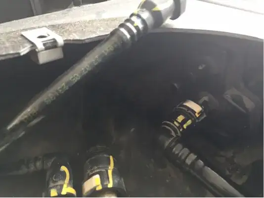

Removing the CAN fuse didn't have any effect. However, I disconnected one of the vapor lines above the gas tank, and was able to fill it up in one go. This is one of the lines I cleared with the air compressor, so I'm guessing the obstruction is on the other side - in that big array of ominous black boxes.
I'll check the canister outlet for spiders later, but at least this is progress (as in, I no longer feel like a redneck who has never had a full tank of gas). (I'm from Oklahoma - i'm allowed to say "redneck.")
Here's the line I disconnected:
Disconnected vapor line

Slow or no flow for fuel in means no or low vapor flow out the vent system. Steps to test for testing for a blocked vent:
  1. Remove the CAN VENT fuse, #64 in the Underhood Bussed Electrical Center (UBEC).
  2. Recheck fuel fill.
  3. If now OK, check the White evaporative vent solenoid wire for a short to ground, between the evaporative vent solenoid on top of the fuel tank to the Electronic Control Module (ECM), pin 55.
  4. If removing the fuse is no help, drop the fuel tank down, check the evaporative vent solenoid, evaporative canister, evaporative vent hose for restriction such as a kink or dirt or spiders.
We pulled several live spiders from a vent tube recently.
