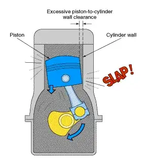

Piston slap is the rocking of the piston in the cylinder (as opposed the desired movement of the piston up and down the cylinder). It happens when there is "too much" room for the piston in the cylinder and the skirt of the piston hits the cylinder wall. Like this:
It can be a design flaw, and it is also exacerbated by wear over time. Aside from rebuilding, there isn't much you can do about it.
