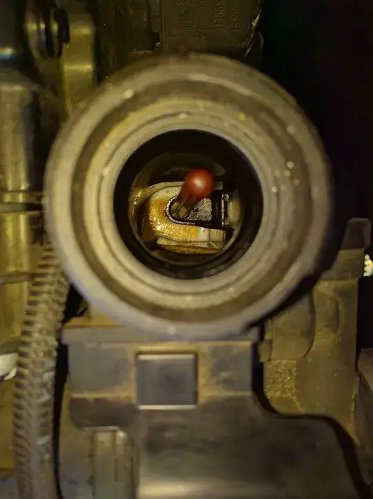

I checked the coolant reservoir and float stick was slightly below the "low line". Nevertheless, the float stick was still floating and there was still some fluid left inside the reservoir.
Peek inside the coolant reservoir

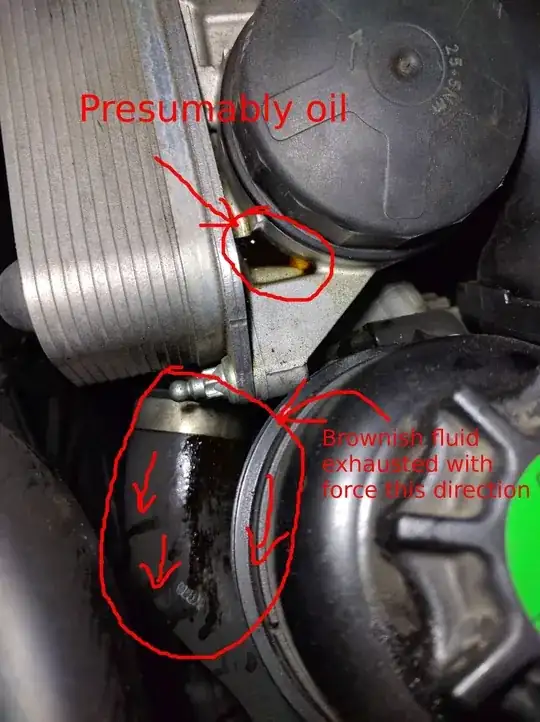

    I am attaching following picture that may provide more hints, because there is fluid exhausted with force from what I think is radiator hose:
    Suspected radiator hose

  • Coolant evaporates and leaves a milky-white stain behind; that's oil on the radiator hose
    Given the oil filter housing is in the nearby vicinity I wouldn't be surprised if the stains are the remnants of a recent oil filter change.
    If the oil hasn't been changed recently, there may be a leak associated with the neighboring oil cooler or a crack in the oil filter housing. The power steering reservoir is also a possible culprit.
    I'd recommend cleaning the oil spots and monitoring to see if the stains return in the short term.

Judging from the picture of the coolant tank with cap off, you have oil mixing with coolant as evidenced by the sludge visible. My X3 did the same thing. The gaskets at the oil filter housing and the oil cooler housing need to be changed.
