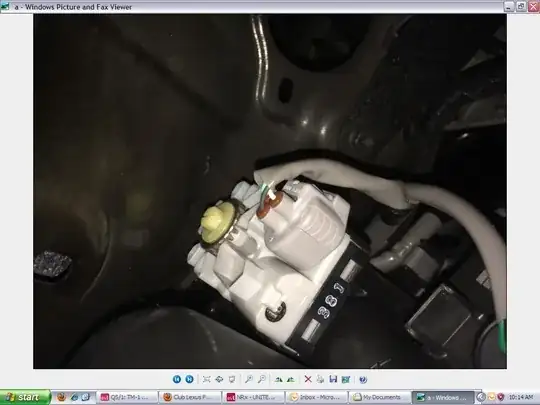

  2. At the base of the back of the headlight there is a white hex nut towards the bottom. Use the wrench/spanner to twist this adjustment nut. I found that rotating the nut anti-clockwise raised the beam level.
    White hex nut
