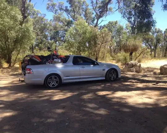

I have, or "had" an immaculate 2010 Holden VE SS 6L 6spd Ute with 18,000 km. The plan was to wack it in a storage for 3 or 4 weeks while in Nz. That would have been no dramas.. But that was July, ... 2014!
2yrs & 4mths & counting What do you reckon? Any advice on what I'll need to do to before attempting startup would be much appreciated.
