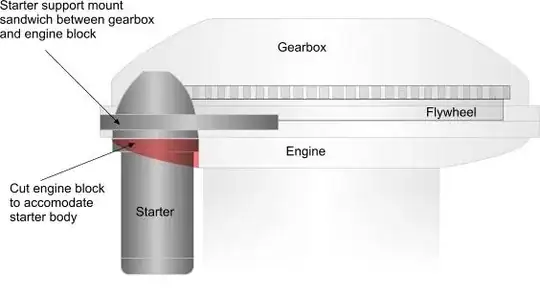

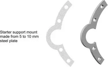

My question is: since I can't find anyone (easily) that can assume building and welding the different support mount, I can make it with steel...but can I bolt it against the engine block wall? I can either put stubs, or pass through bolts to secure the support mount, then attach the starter to that mount. Or I can make the support mount be fixed between the engine and the gearbox, filing its thickness on both surfaces and attach it with the same bolts they use to get assembled together.
On the sandwich mount idea, I did some quick graphics to illustrate better what I mean. Nothing exact, just the idea. Any comments are welcome!
Both facing surfaces from the gearbox and the engine could be debasted to be able to insert the support mount...

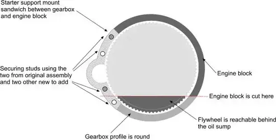

I can use the the stub for hanging the exhaust silencer, and convert the existent bolt on top to a stub (dark gray circles). Then add another two passing through bolts to secure the mount better.
The thing would look like this, in some quick 3D
