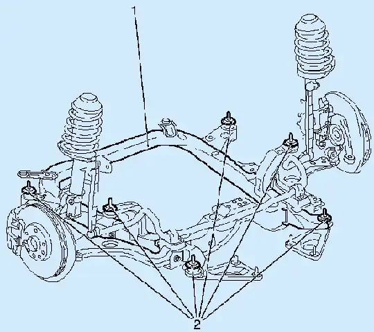

The following link illustrates the control arm. Link
I also have a illustration of the suspension enter image description here
Both stabilizer links got replaced by me because the seals where ruptured (one before the gearbox repair, one after).
When I changed the wheels two weeks ago there was no feel-able play on the wheel/stabilizer links/control arm/steering knuckle. I am a bit unsure of those results because I did not use a crowbar/similar tool to check the control arm and the stabilizer links where under tension because I was using a single car jack to raise the vehicle.
I am inclined to think that ball joint on the control arm is worn, perhaps somebody could point out other candidates or checks?
