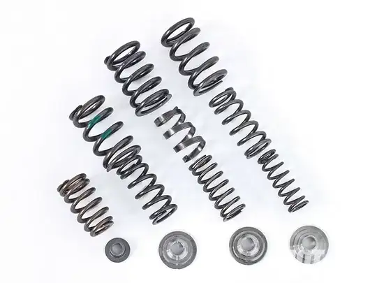

  • new dual or triple valve springs can make noise as they wear in. Not sure if you have these though. below is a picture
until we can hear a recording of it we probably won't be able to pinpoint what the noise might be.
all the dual and tripple springs can have a tight fit causing them to rub on eachother until they are broken in. as they do this they will make a very distinct noise.
