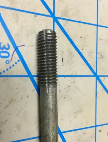

I have seen this happen in Harleys aluminum heads (I think it was the rocker cover bolt). However in the older vintage bikes I have seen they cut a grove down the threads for blind hole stud and bolts. As there are lots of threads the integrity should be fine but the pressure can be relived. Picture is 1956 Royal Enfield blind hole stud pressure relief grove Royal Enfield 1956
Blind holes are not threaded perfectly to the bottom. There is some taper to the end of the threads. Forcing a bolt too deep could cause the cracking you see. This is why studs are usually used on blind holes instead of bolts. Once the stud bottoms in the blind hole, the nut on top tightens until torqued properly. Again with hydraulicing, the forces against further insertion should stop the stud from rotating and tighten at the nut. If you have to use bolts, user shorter ones than the full depth of the hole.
