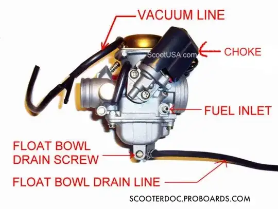

Your carburettor probably looks something like this:

According to the diagram at the top, the location you are talking about is simply a bowl drain. It is used when you are doing a carb cleaning, or, more frequently, a carb flush. I have personally used float bowl drains for emptying bad fuel or fuel with the wrong octane rating out of the carb so that I can have fresh going into the motor.
The hose is simply so that if you have to perform a carb drain, it doesn't drop the fuel on the hot engine.
TL;DR: Nothing's missing. If ever you do a carb drain, you might want to hook a tube onto that nozzle. Otherwise, it won't affect your engine at all.
