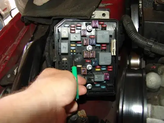

This should help ... here's where it's located under the hood:
2007 Monte Carlo Fuse Panel Location

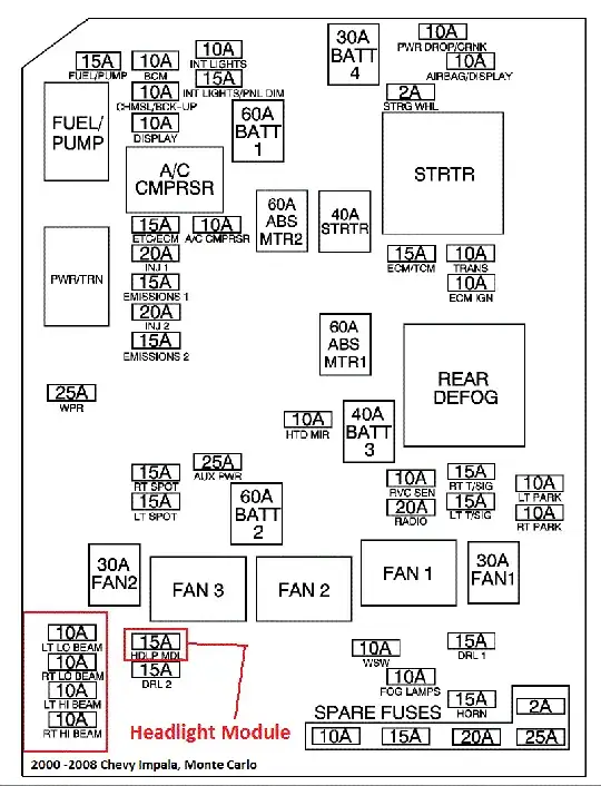

Here's what the fuse panel layout:
2007 Monte Carlo Fuse Panel Layout
Please note there are three relays and two 30A fuses there.
