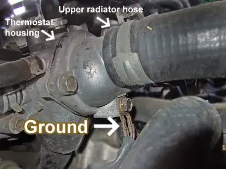

The other place to aim it is near the block on the engine side of the thermostat housing if you can. This reading will show us what temp the thermostat is being bathed in. below is a pic of your thermostat housing. we want to hit just about 1/2 inch behind that gasket away from the hose side. maybe even the smaller black rubber hose going to it in that image near the "thermostat housing" arrow.
If it is cold where you live this would exacerbate the problem since a closed thermostat would let the coolant in the radiator get extra cold. This could potentially cause engine damage in the form of warped heads cracked block or heads and other potential problems. It would be the same as dumping a hot 100 deg c pan into icy cool water. To help avoid this put some cardboard in front of the radiator leaving just enough open radiator to keep the thermostat open while driving but not too little to cause real over heating.
