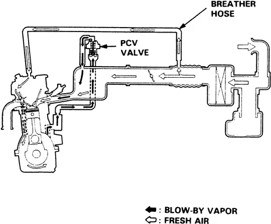

It looks like Volvo is doing something a little abnormal where they have integrated the PCV valve with an oil trap and possibly a couple other components. Lets break it all down:

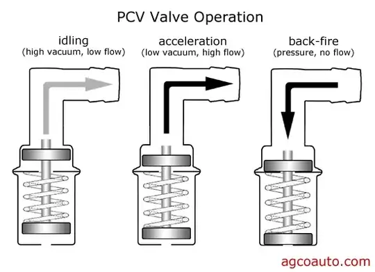

PCV Valve -- positive crankcase ventilation valve
This is used to pull gases that collect in the crankcase, through the intake to get burned in the combustion chamber. It is a valve to protect the engine from backfires as shown below:
PCV Valve operation
This is how it hooks up on an engine:
Since there is suction these can get clogged with oil which Volvo looks to have addressed with their part.

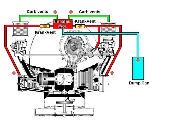

A breather / breather box is a little different. it is merely a filter system that allows crankcase pressures to vent out the engine. below is a breather box used as an upgrade for VW bugs

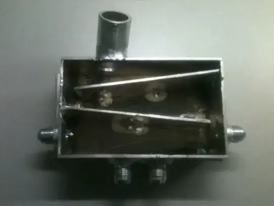

and what they look like inside
they are typically accompanied with a catch can for the oil that finds its way into the box.

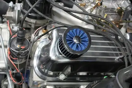

This is the simplest type of ventilation setup you can have also simply called a breather
it is just a simple filter sticking out of the valve cover.
