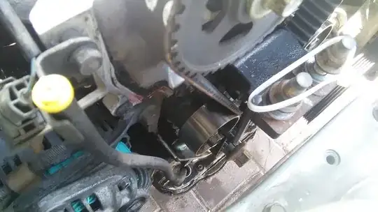

Here's a picture of how I got the tensioner spring on by holding the tensioner with a zip tie:

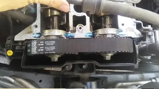

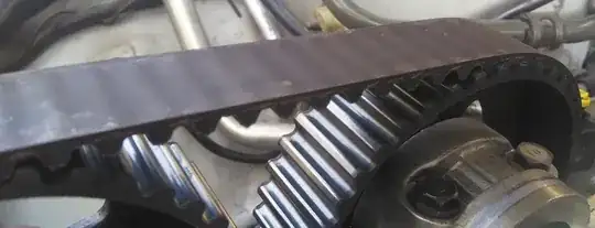

So I pulled off the valve cover and upper timing cover and took a look at the belt:
I've run the belt maybe ten minutes total, and the outside part which contacts the tensioner and idler pulley already has this kind of smudged look to it ( don't know if that shows up so well in the picture ).

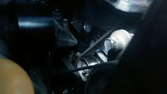

I also took an approximately one minute video of the belt with the engine running and there is no wobble in the belt and no noticeable movement of the tensioner or tensioner spring. However you can hear the noise very clearly in the video.
So here is my theory at the moment. When I tested the tensioner and idler I spun them and listened for any noise. I didn't hear any noise so I figured they were good. However, when I spun them they only turned a few times before stopping, which is in contrast to what I'm seeing in this video in which the guy spins a t-belt pulley and it spins freely for quite a while.
So I'm wondering if the bearings in my tensioner and idler pulleys are somewhat worn out to the point that the the pressure from a brand new belt is sufficiently greater than the pressure from the old belt and that's making them make noise where they didn't make noise before.

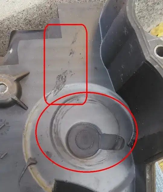

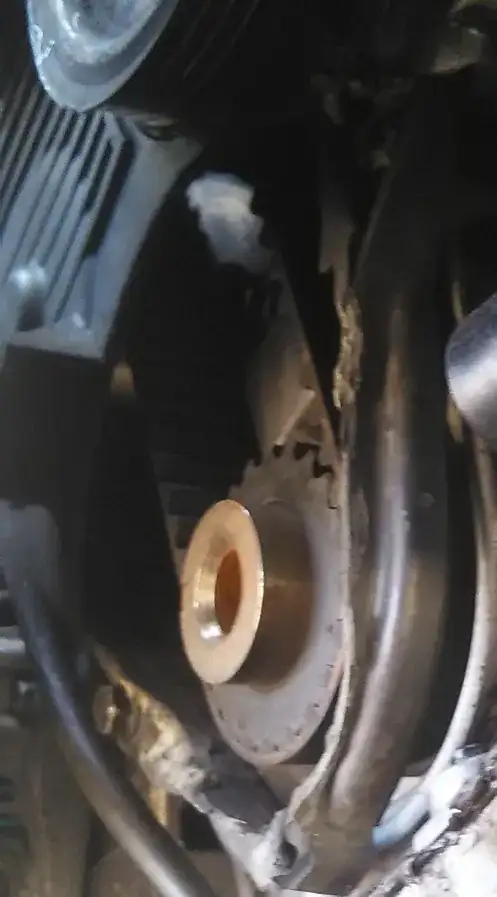

When I pulled off the lower timing cover I noticed a few things:

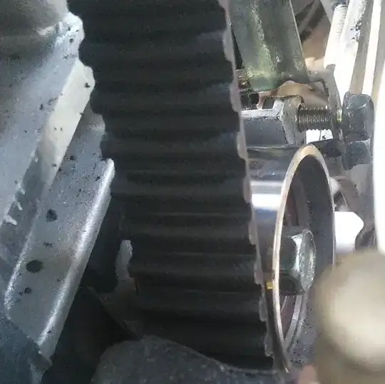

The first thing I noticed which I didn't really pay attention to before is that the t-belt cover is severely warped. So much so, that it's contacting the back of the crank pulley body and the crank timing teeth and has burnished them silver.

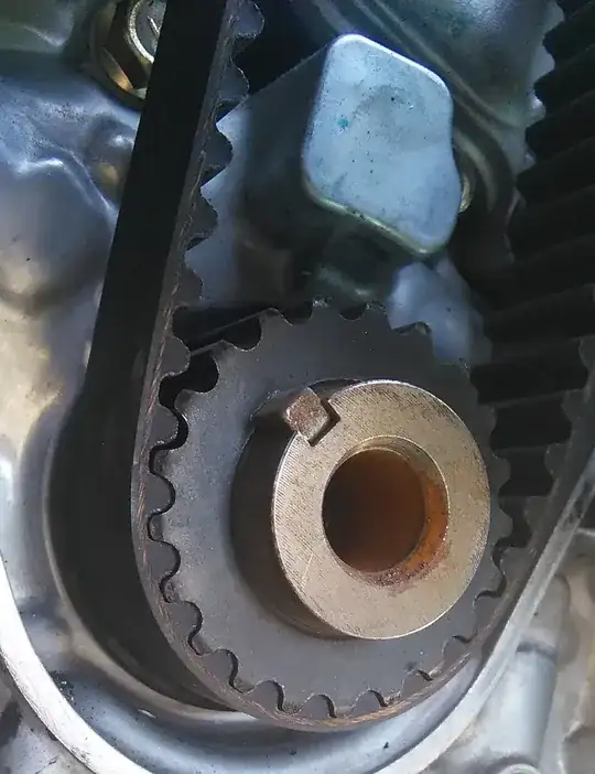

The second thing I noticed was that the belt was sitting at the very edge of the sprocket and the edge of the belt had been rubbed off enough that you could see the copper strands in the belt itself. You can see it clearly here after I pushed the belt as far onto the sprocket as it would go:
After I pushed the t-belt all the way onto the crank sprocket it also automatically lined up properly right in the middle of the idler pulley:
I also noticed similar wear ( although not as bad ) on the back of the belt:
So remember what I said about the timing cover being severely warped? Well it looks like both the belt and the tensioner pulley have at some point been rubbing against the inside of the timing cover:
The thing is of course that I don't know when this happened, as I didn't pay any attention to the inside of the cover when I originally took it off, and the size of the circular scratch is about half a centimeter smaller than the diameter of the tensioner pulley.
This just gets more and more confusing. I'm thinking that maybe my first course of action should be to replace the timing cover, since it's clearly warped and has contacted the belt and tensioner at some time, either in the present or the past.

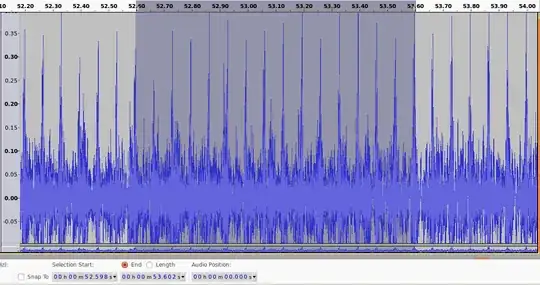

I decided to see if I could improve a little on Zack's truly excellent answer with some more exact measurements and data. So I took the video and loaded it into Audacity audio software, and zoomed in a bit to look more closely at the audio data:
As can be seen in the highlighted area, the clicking noise heard in the video is extremely uniform and occurs at a rate of exactly 16 clicks per second, or 16 Hertz. Looking through the entire audio file confirms this rate, even if an occasional click is muffled or missed here and there.

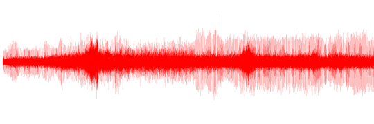

I analyzed the audio waveform in your first video: Audio Waveform
See the two bigger spots? Those are cars passing by. Look at the first bigger blob; it has has two peaks within it. The first peak is at 14.5 seconds. I counted the number of ticks (or where there should have been a tick, but camera movement interrupted the mic). I got 205 ticks in the first 14.5 seconds.
(# of ticks) / (time in s) = (frequency in Hz)
205 / 14.5 = 14.14
The tick occurs 14.14 times per second, aka 14 Hz.
The time between ticks is (almost) perfectly uniform. This is not a random slapping.
