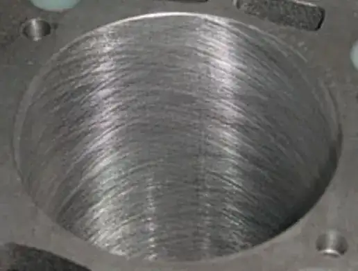

Over boring the cylinder is a process to ensure the wall of the cylinder is pristine, providing a sealing surface for the rings to mate. Often when an engine gets old and tired, there will become scuffs in the the cylinder wall surface. This is an example of a scuffed cylinder wall:
Scuffed Cylinder
After boring and honing, the cylinder should look something like this:
Honed Cylinder
In the picture you can see the cross hatching. This is caused from the honing operation and helps the rings "seat" during the break in process. When the term "seat" is used, it means the ring is worn down slightly, allowing it to mate to the cylinder wall, and form a seal which holds compression in the cylinder/combustion chamber, as well as keeping oil out. A secondary purpose of boring the cylinder is to ensure it is completely round. To do this correctly, the shop should use a torque plate, which is attached to the deck during boring and final honing. This simulates the head being attached to the block during the process, so when the head is finally attached, all the little variances are accounted for and the cylinder is as close to round as can be made.
