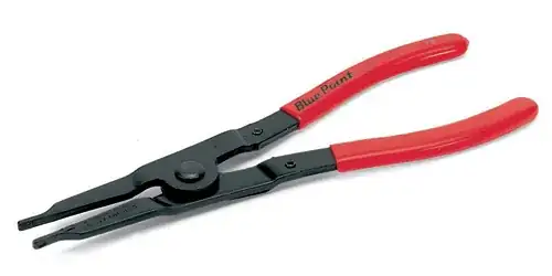

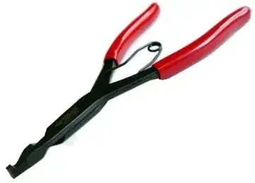

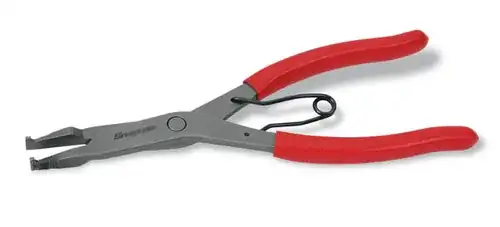

Get yourself some retaining ring pliers. You can get them with fixed or interchangeable tips. The interchangeable are cheaper but the fixed tip pliers are better in my opinion. I feel they engage more solidly and predictably than the interchange tip models I've used.
Something with flat tips will work. Like these: enter image description here enter image description here enter image description here

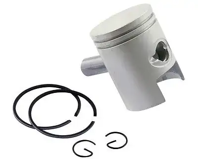

I don't know the situation of your car or cars in general.
But pistons for my scooter come with G- or C-style clips, and have a grove through the bore of the bolt, as shown in the picture below. It's quite easy to grip the clips with needlenose pliers to remove or install them. This works even better if the teeth of the pliers are a little bigger than normal. Ah, and don't grip the clip from the opposed sides, just the wire on one side.
