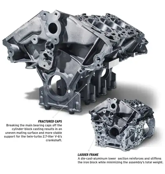

With that said, cast iron is still being used in the manufacturing of engine blocks, but not nearly as much as it used to. Take for instance Ford. They are using cast iron in their twin-turbo V6 engines which they debuted about two years ago. The block for this application is not what you'd consider "typical". It's actually a hybrid block consisting of the cylinders and main bearing sections being formed out of what is called compact graphite iron (CGI). It's also called vermicular graphite iron.
Ford's block is only about 1/2 CGI, the other half being made out of aluminum. While the CGI provides toughness where it's needed, the aluminum provides strength and stability at a much lower weight penalty.
