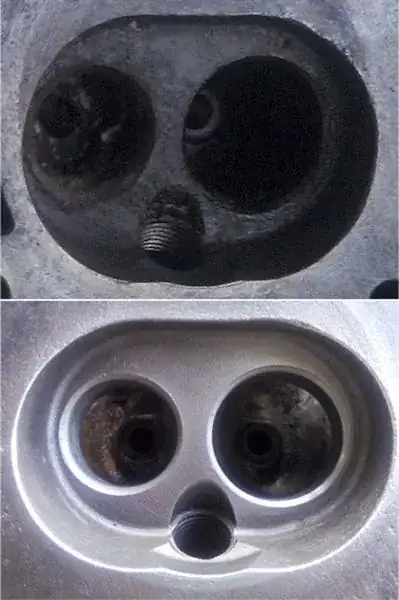

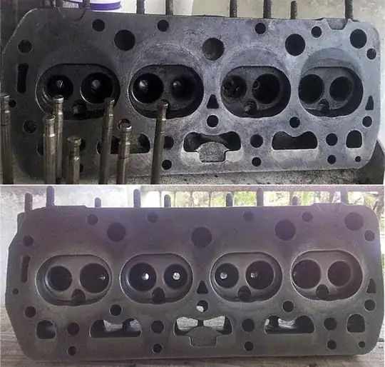

I did some work on my engine's head valves and their seats. This is a very old engine with very old/abused/invented/adapted parts, etc.

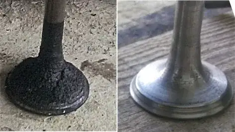

Both the valves and seats were in pitiful condition. In some cases, they required using a small chisel and hammer to get rid of carbon deposits! I even polished the chambers with a dremel, drill, etc.

I did some lap, first coarse (150 grits), next fine (600 grits), and then put them almost mirror polish (that green dremel paste...).
When I tried to turn the valves with a very soft thumb push, they wouldn't rotate on their seat. I think this means they are matching tight. Is that correct?

I put the spark plugs, valves facing up, then poured thinner into the chambers. None, but one put the port "wet", but not dripping. I took that one valve's springs off, relapped a bit, and put it back.
Now, almost all the valves are wetting the ports!
When I say "wetting", I mean: they don't flood, I can't see drops, but if I pass the finger inside, I can pick a very very thin layer of thinner.
When I poured the thinner to the top of the chamber, I couldn't really see the level drop at all in the 10 or 15 minutes I tried. I could see the meniscus just there.

BEFORE AND AFTER :)
