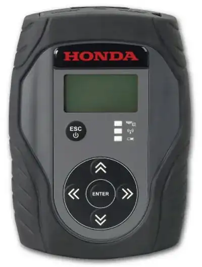

HDS HIM stands for Honda Diagnostic System - Honda Interface Module. This is the current HIM. It interfaces with a PC to run scan tool software and is a standalone module reflash unit. It requires a current Honda OEM software subscription to function.
Current HDS HIM
The device you reference is not an OEM device. Honda has used at least three interface devices but that is not one of them. The Honda authorized device costs much more then the amount asked for in the link.
Info on the Honda tools and software susciptions are a available at techinfo.honda.com. The techinfo site is the official site for OEM scan tool info. Most OEM's are listed there.

Actullay the picture above is not a Honda HDS HIM interface, it's a Honda MVCI interface.
Honda HDS (Honda & Acura Diagnostic System) is the latest diagnostic software for Honda vehicles. Diagnostic functions available for vehicles of HONDA/ACURA from year 1992 to 2007. Test coverage: Dynamical, Body, Chassis, ABS, SRS, Anti-theft, etc. HDS supports CAN BUS system, and it can re-program the Auto ECU.
HIM is the host with double board (see picture below).
So Honda HDS is the copied software load on a third-party HIM firmware. You need an RS-232 port on your computer. If your computer doesn't natively have one, you'll need a USB->RS-232 adapter. Software updates frequently.
I have successfully used the TPMS features, CKP relearn, idle relearn, ECU reset, and cleared DTS faults. I belive this thing can data log, reprogram gauge clusters, and reprogram the immobilizer for new keys, but have not tried these things yet. enter image description here
