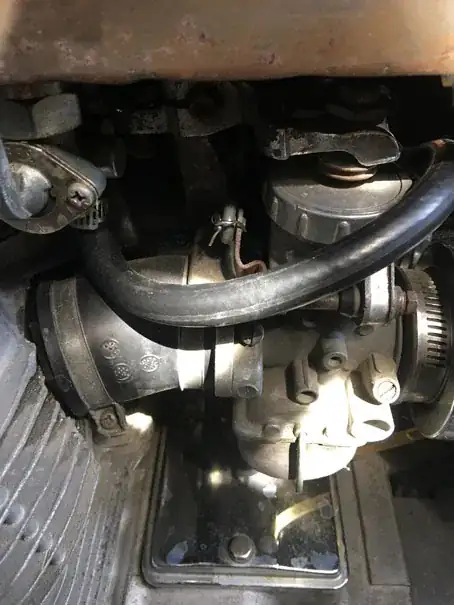

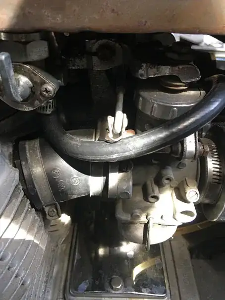

1) The choke 'on' would be when it's pulled out, correct? I can't seem to find any other chokes online that look like mine but I'm just making the guess by looking at it:
ON? enter image description here
OFF? enter image description here
If this is correct, I left the choke on for like a week since I've had it. I did an oil change and now the engine won't start. It turns but won't fire. My guess is that by keeping the choke on, I screwed up the spark plugs and need to replace those so that's what I'm going to look at first.

Your carburetor looks like a Mikuni VM series, though I could be mistaken. Usually, pulling up the choke engages it, meaning that more gas per amount of air is flowing into the engine (air input is choked). Once the engine is running, you can allow the correct amount of air to flow into the engine (provided your carb is adjusted correctly) by pushing the choke in.
If you ran your engine with too much gas going into the engine for an extended period of time, there are good chances that you will have to change your spark plug as you suggested.

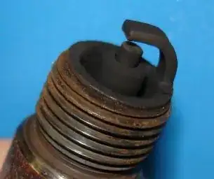

You should be able to roughly diagnose this with a look at the spark plug. If it is covered with black almost fuzzy carbon deposits, it is a sign that frequently indicates that the motor is running too rich. Essentially, the fuel isn't all burning because of an insufficient oxygen supply, and the partially un-burned fuel deposits on the piston head, the cylinder walls, and the spark plug.
A picture from http://www.aa1car.com/library/spark_plug_fouling.htm of a carbon fouled plug:
The carbon will short out your plug instead of bridging the gap correctly, therefore the engine will not start (insufficient spark). The spark plug will need replacing - unless you feel up to attempting a cleaning. (Something I have done numerous times with success, but not something I recommend: spark plugs don't cost that much. :) )
