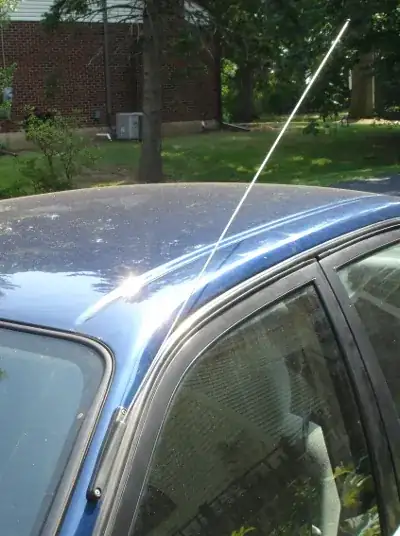

If its an old-school outside aerial like this one, then water could have entered along the shaft. Blast it with contact cleaner while rotating and pushing the aerial in and out, while listening for a change/improvement.

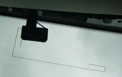

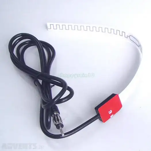

If its a stick-on aerial inside one of your windows, then check for scratches that may have damaged the thin wire. Some have many more wires on the glass than that. Also look closely at the box that connects the sticker-wires to real wires. They can suffer with bouncing and vibrations.
Additionally, some vehicles use the rear window defogger/demister as an aerial. Scratches can be repaired with conductive paint, which can't hurt.

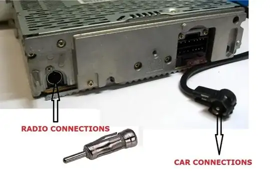

Plug
At the back of most car radios is a jack and socket that looks like it came from the 1950s. It probably did. While the plug is long, it is still only a friction connector and can suffer from wear.
Downside, to see this you'll need to pull the radio out, which normally means a load of fascia and trim needs removing, and possibly special unclip sliding things in the side.

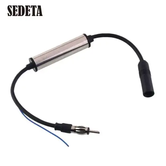

Does your radio have a "band expander" fitted? They can go bad with age, or with poor grounding. These are used to slide a FM band "over" a bit, and are common in cars that have been imported used.
Here in New Zealand, our FM radio stations about 88-108 MHz, and used Japanese car radios tend to be 70-90 MHz. So the band expander adds about 18 MHz.
[band expander4]
