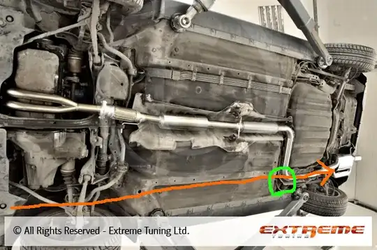

The ties hit the exhaust system pretty hard. Here is a picture, this is somebody else's car with an aftermarket exhaust but it at least shows the routing (railroad tie path is orange arrow):
enter image description here (image source, also thanks @Myself for finding that).
The car was squeaking a lot after that which turned out to be a bent heat shield rubbing against the exhaust pipe (circled in green above), an easy fix, I corrected it later that day. I didn't notice any other damage on a closer visual inspection. The cat is on the centerline, I didn't hit it directly, but I'm sure I stressed the whole system hitting the pipe in the back.
