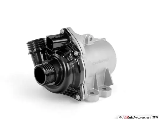

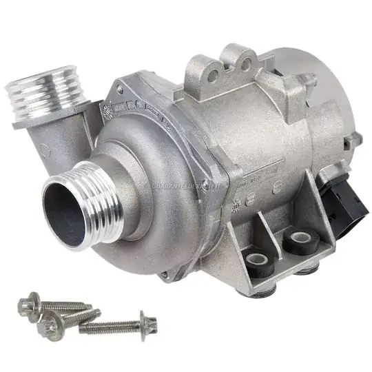

So today i've been told that the reason of leaking coolant fluid is my water pump(again). It is over 400$
The car is 535xi 2008 year. It's second time in a year that waterpump cracked.
I cant understand what were they thinking when they made plastic WP...
Now im thinking of getting Waterpump for N52 which is made of aluminium.
It is quite cheaper and i think it will last much longer.
My question is: What do you think? Will I be able to install Waterpump from N52 to N54 ?
As far as i can see from google search the only reasonable difference between them is in electric connector.
Below you can find sample pictures of each: N54 N52

While I know you're asking about fit specifically, keep the following in mind, which I found on a forum discussing the differences between the N54 and N52:
Both engines have an electric coolant pump, but the N54 has a 400W pump (9000 l/h), while the N52 has a 200W pump (7000 l/h)
While the 528 is normally aspirated and probably doesn't need that extra cooling capacity, the 535 is turbocharged. There is a lot of extra heat associated with turbocharging and you could face overheating issues, which will cost you a lot more than a new water pump. It is a difference you should be aware of.
Traditionally water pump failure on these cars has been in the electronics, not the pump itself. You might want to look into why your pumps are cracking. Look for things that might be moving around but shouldn't. Did your mechanic over-tighten a clamp on the impeller housing? I know X3s used aluminum bolts for the engine mounts and those can break. I don't know about the 5s, but it's something to check. Also you should definitely inquire about a parts warranty. Less than 1 year of service life is shady even for the cheapest AutoZone parts.

In terms of physical fit:
  • you need a little more clearance at the back to accommodate the electrical connector with the aluminum pump.
  • the mounting points look identical
  • the coolant inlet and outlet hose connection points will not change
That said, something is not right. Why would a water pump fail so quickly again? If it is legitimately a manufacturing issue, like the S62's thermostat, I would consider getting the repair done at an authorized dealer so that the part is under warranty for a certain period after the fix.
