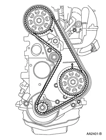

To check the engine timing take a look at this image.
You can see that the camshaft mark (black triangle), oil pump sprocket mark (diamond) are lined up with a corresponding mark on the inner timing cover. While the crankshaft keyway is pointing at 12 o'clock.
If cam/crank timing is off make sure when you rerun the belt that the slack is on the tensioner side of the belt. Once you put tension on the belt rotate the engine by hand 720° or two revolutions and verify that the timing marks are lined up correctly.
