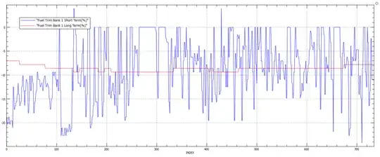

And some random readings from my car over a period of about 12 minutes while driving:
The descriptions combined with the graph seem to confirm that the reported long term value is pretty much just a running windowed average of the short term value.
The short term value seems to be what's actually applied. The long term value is just the short term average over time.
So my question is this: Does the ECU actually do anything with the long term fuel trim value and, if so, what does it do? Or is it merely diagnostics info for humans?
If the long term value was being used, at least in closed-loop mode, then I would expect short term readings to be centered around 0, but it seems like all action is represented entirely by the short term values, and the long term values are just a report.
