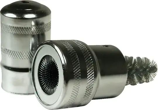

A corroded battery terminal or engine ground could prevent the battery from getting it's proper amperage from the alternator, so this is your first task: clean the connector and the post. Battery terminal cleaning brushes are rather cheap, get one that looks like this: battery terminal cleaner
