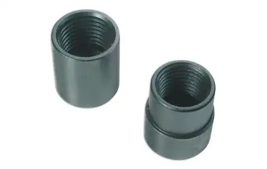

There are sockets designed specifically for this job. Here is an example of one; they have a reverse thread on them and are made of hardened material so as you turn them anti-clockwise, they tighten themselves over the locked wheel nut until they are fully tight and the nut begins to loosen.
They are made by most tool manufacturers and available from most tool and auto shops.
