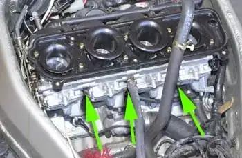

  • you will insert those brass fittings into your manifold after removing the plug screw. The plug screw, if not removed for some time, will have fused to the aluminum because the screw has some iron in it. The oxidation melds together, I forgot the name of the process. IF the screw is stuck, hit with a torch for a bit and squirt water right on the screw. The expansion and contraction should free it up enough to break it (the bond) so you can get it out.
On almost all four cylinder MC's you balance the bank in pairs.
  • Balance carb/cylinder 1 and 2 together
  • Balance carb/cylinder 3 and 4 together
  • Balance pair 1 and 2 to the pair of 3 and 4
There are only three screws to balance the 4 carburetors together. One for each 'pair' of balancing you do.

Location of the balancing screws
  • Reminder - make sure your fuel screws, float levels and AFR are good on all of them first. In a shop, synchronization is always done after everything else is completed.
