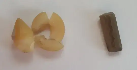

I was wondering if anyone could help me identify what could be a part, or a piece of a part, from my 2003 Honda CR-V. Yesterday, I noticed that the stop lights stayed on after I turned the vehicle off and I found the following pieces on the floor mat:enter image description here
On the left, I believe, is a shattered 46505-SA5-000 (brake pedal stop pad), but I'm not sure about the piece on the right. For all I know, it could just be debris and not even a part, but I thought I'd ask because if it is a part, then maybe I should take the vehicle to a mechanic.

The white part is definitely the brake switch stop pad. A common failure. The other is not as clear, could be the end of the brake switch plunger rod.
Is it plastic or metal?
