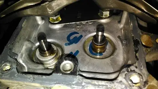

I've read that the valve guides on these engines can move which can lead to bent rods, but I'm not really sure what they're supposed to look like before they've moved. Do these look OK?
Valve Guides

The cause of the bent push rod is the valve guide thimble is only press fitted, and easily loosens when the engine reaches a certain temp. The thimble then pushes outward, restricting the movement of the valve spring, eventually causing the push rod to bend. This is a design flaw in current B&S engines. I have no idea how long this flaw has been around. but it's quite a problem. They say it's because the engine overheats, due to restricted air flow, or inadequate oil maintenance, or ? But those who've encountered the problem often cite no problems with restricted air flow and always made sure the oil was changed frequently and kept topped off. In my opinion, this design flaw might be solved by removing the valve guide thimble, machining grooves in both ends, countersinking the head on both ends, then reinstalling the thimble with C clips on both ends. This would prevent any future movement of the guide thimble. I've yet to put this to the test, but something along this line needs to be done because this is a real problem, and new heads are currently at least $150. IF someone can solve this issue, I bet there'd be quite a market for rebuilding the heads.

In my case, valve guide pushed upward into valve spring after getting hot. Dead chipmunk in engine makes for poor airflow. Valve spring top now hits the valve guide, bending the pushrod. Remove spring and push guide back into head. Re-peen. Make sure valve moves freely in guide and is not bent or sticking.
