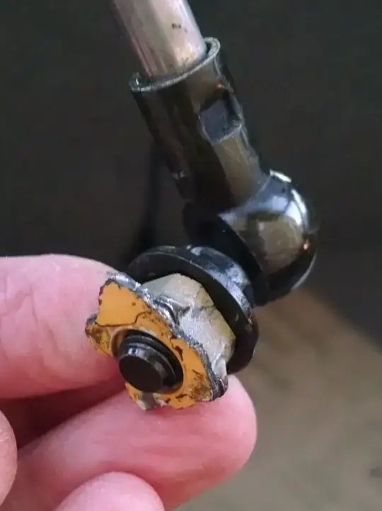

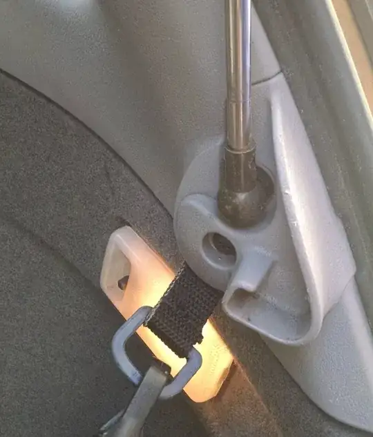

I have a 2003 Subaru WRX (in the USA) and the left tailgate strut attachment point is badly damaged.
I have asked a few body shops and quotes are typically in the $500+ range to repair the damage by welding. I can live with it, but was hoping to find cheaper suggestions. The fix doesn't have to look pretty.
I am not sure how the damage occurred, presumably it was as a result of a rear-ending a few months ago.
Any suggestions would be much appreciated.
Attachment point
The body part is on backwards here:
End of tailgate strut, 'body' part on backwards
Other side: enter image description here

If you're trying to secure the tailgate strut attachment point:
I can't see any way to proceed that doesn't involve removing the plastic trim from this area. It isn't super difficult but it will be tedious to carefully remove the brittle plastic fasteners holding the trim in place and trying not to crack the equally brittle trim plastic.
With the plastic trim set aside, you'll have more room to maneuver. If you look at the bolt coming out of the tailgate support strut, it's fairly slim (it's not a toothpick but it's definitely not a motor mount bolt). It's also actually not a bolt: it's the ball end of a ball-joint. You won't need to put a great big nut on it once you have a secure mounting point.
With your situation, the mounting point is the problem. If you look at the sheet metal that the strut was attached to, it also isn't beefy. You don't need a lot of structure there but you do need some. My previous points about "maybe a washer will be sufficient" would apply to this situation except for one problem: movement.
At this point, my expectation is that an unsecured attachment point will have enough play that the tailgate will flex and rattle at every opportunity. A better solution would be to drill out a thin piece of sheet steel that has the correct spacing for both bolts (cargo and strut).
You'll then need to attach that patch to the sheet metal. It's possible that a welding shop may be willing to attach that to your car in the right location for a decent price but I don't know what your market is like. If you're not going to weld the patch in place, it's possible JB Weld (or the equivalent) might hold the patch in place but I'll let you make that call.
Once you've patched the hole, you'll have a backing plate to which you can secure the strut and the cargo cover attachment point.
