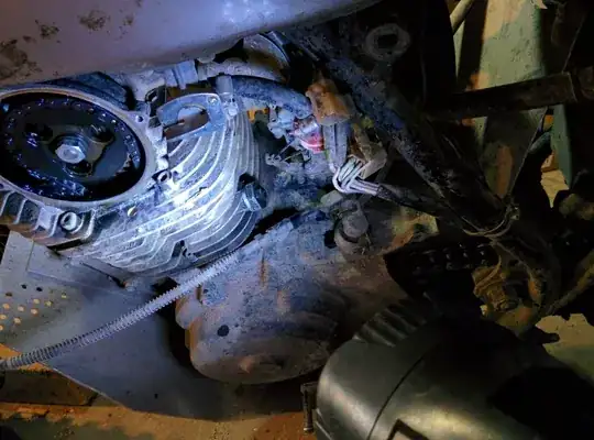

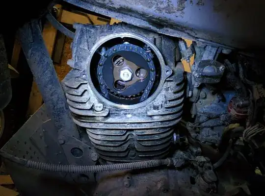

I have a 1981 Yamaha XT250H.
This motorcycle uses a single cylinder engine with a single overhead cam and two valves. The timing chain has two guides, one on both sides of the timing chain. The adjuster threads into the cylinder block on the right hand side. It uses a piston and a spring to adjust the timing chain. To get the tension anywhere near correct I have to turn the adjuster all the way in. There is no way to get the cover back on after that.
Does this indicate my timing chain needs to be replaced?
enter image description here Imgur

Your cam chain has reached the end of it's service life
Your cam chain is stretched beyond service limits it appears. If you have no more adjustment available to push your cam chain guide against your cam chain then you can no longer take up the slack that is created as the chain continues to stretch and lengthen due to normal use.
  • You should not have to split your cases to access the crank sprocket for the cam chain.
  • Ensure you put the crank at TDC and mark your camshaft if you choose to remove the cam chain to replace it with a new one
  • Check your cam chain guides for cracking and splitting while you have the covers off the side of the motor. Replace as necessary.
  • Procure a shop manual from Yamaha if you can. The aftermarket manuals leave something to be desired.
