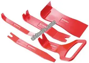

2. Possibility: plastic levers
Use some plastic levers to gently pry out the oil-pan. Since the levers are made of plastic they are unlikely to damage the mating surface.
