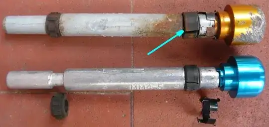

A while back I crashed the bike, and I've been doing it up in piecemeal fashion. When I came to replace the scratched handlebar weights, I found the internal bar had snapped, at the location of the blue arrow on the picture.
The remaining portion of the bar didn't hold the shiny new weight - the weight would loosen and fall out whilst riding. So I purchased a whole new bar.
Old vs New Internal Weight Bar enter image description here

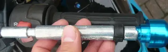

Seems simple enough, but I've found the new bar doesn't fit. It's too long. It sticks out by about an inch.
But it's the same length as the old bar? Yes.
So I tried the old bar back in, and that doesn't fit either. Now that makes no sense, because it obviously fitted before the crash.

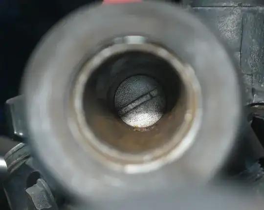

There is nothing stuck up inside the hollow of the handlebar.

New Bar Sticks Out enter image description here
Size Comparison External enter image description here
Nothing Inside Hollow of Handlebar enter image description here

Looks like that split ring compresses when the weight bar is pushed in the handle bar which then keeps it in place. Have you tried tapping it in with a rubber mallet or something similar?
