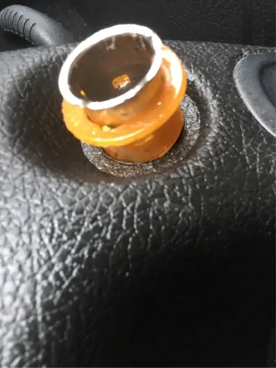

I revisited this after a few weeks and it turns out that quite a bit of force was needed. I used a claw hammer under the orange outer sleeve to pull it half way out and give myself a bit more access.
half removed cigarette lighter
The inner sleeve was still firmly stuck to the orange one however. I used some WD40 at this point (having previously been a bit worried that it might catch fire if used so avoided it) and a screwdriver to lever out the inner sleeve to the point pictured above, but then it was completely wedged.

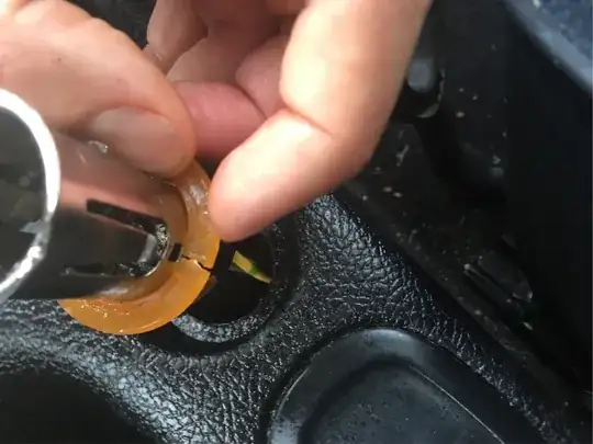

I eventually used a pair of long nosed pliers in a twisting motion to snap the outer orange ring and release the tension:
snapped outer sleeve
From there I could remove all the bits very easily, cleaned up the excess WD40 and fitted the replacement. The fuse needed changing as during my levering it had shorted (turns out on my model of 1999 206 the cigarette lighter is always on rather than on the ignition switch).
Interestingly when I got the component out it did not have either of the retaining clips mentioned in that tutorial - it was a one piece unit not designed to be removed. This probably explains why it was so much harder than expected to remove.
